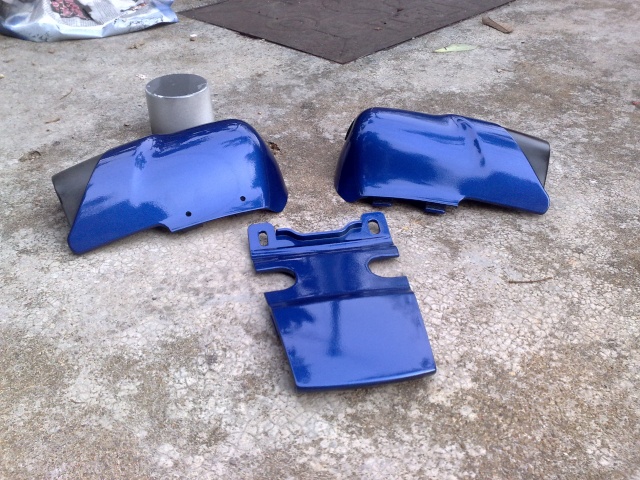

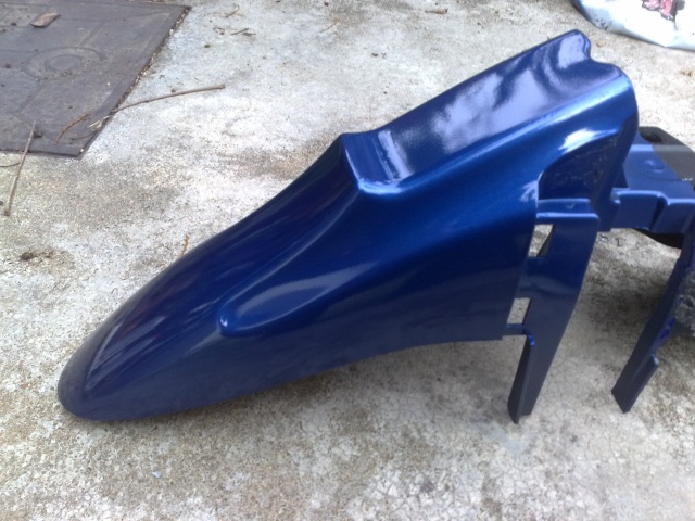

| Subject: Re: Re-paint Coverset Mon May 10, 2010 6:48 pm | |

| Subject: Re: Re-paint Coverset Mon May 10, 2010 7:03 pm | |

chocolate Laksamana Armada

| Subject: Re: Re-paint Coverset Mon May 10, 2010 7:08 pm | |
Posts : 3215 Join date : 22/03/2009 Age : 37 Location : terengganu,bangi,kuala lumpur
| Subject: Re: Re-paint Coverset Mon May 10, 2010 7:18 pm | |
| hahaha xde pun yg meleleh,aku sembur nipis2 tp 2-3 layer,tu sbb clear nmpak cam kureng jer tu
kover horn tu ada part yg aku tertekan masa blum kering btol2,x sabor nak tgk kl dah pasang jadi camner,tu nampak cam leleh tu

mantadkb Laksamana Armada
Posts : 2361 Join date : 22/03/2009 Age : 40 Location : kota belud
| Subject: Re: Re-paint Coverset Mon May 10, 2010 7:29 pm | |

| Subject: Re: Re-paint Coverset Mon May 10, 2010 8:25 pm | |
