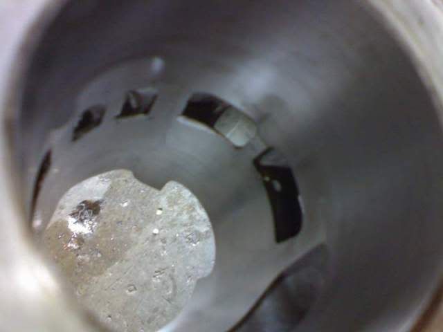

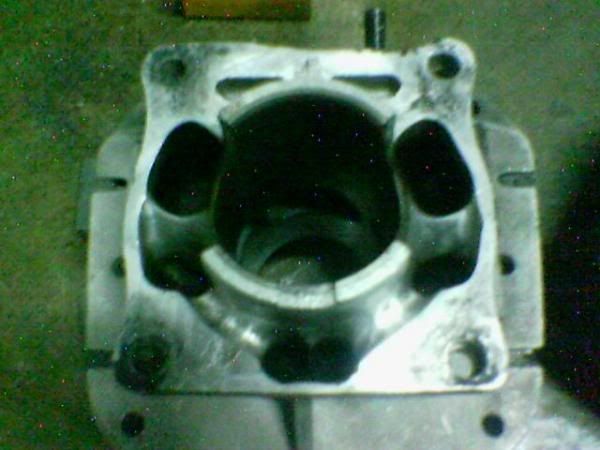

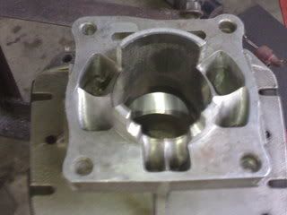

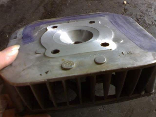

hm........sy ade few sample blok2 ni......nanti bro Wan tolong explain lubang2 semua tu..........tapi gambar collection blok2 ni agak ganaslah.......tak sesuai pakai harian.......jap,10minit...........amik masa upload..................hope all member enjoy.....tapi jgn simply DIY...........warning.....!!!! Surprised Surprised
PostSubject: Re: Korek, Potong, Rebore, Port, Polish Blok & Potong Head   Tue Jul 21, 2009 1:47 am
ok....dah siap.......... cheers
1)Ni yg dimaksudkan otai2 selama ni........potong head......hehe....
2)4 lubang angin diport..........yg bawah tu lubang minyak tak pasti camne nak bagi cun......
3)Ni jugak lubang2 angin???nak kena port gak ke???
4)Ni lubang ekzos........tanya bro Wan camne nak buat.........sy bagi sample je...ok
5)Ni adelah blok yg dah diport dan dipolish..............berkilat..........kebaikan@keburukan tanya member2 lain yg pernah buat.......

PostSubject: Re: Korek, Potong, Rebore, Port, Polish Blok & Potong Head   Tue Jul 21, 2009 3:38 pm
yg head tu potong brape mm?0.5 eh?aku nye dah rate habis..hehe...
*head jgn potong lebih2 sgt,compression tggi sgt nanti gasket asek bocor je,knocking pun satu hal..(gambar 1)
lubang angin yg 4 lubang tula.. biasenye org wat bagi cam smooth utk direct angin..(gamba 2) belah dalam x yah kacau..(gamba 3)
lubang myk yang 2 lubang kecik tu xyah usik,nanti myk kuat..kat situ la tempat reedvalve..
lubang ekzos ade ukuran melintang n menegak.. aku nye menegak 28,melintang 41.. try la klau korg nak try...
