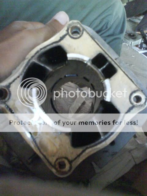

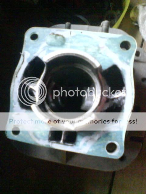

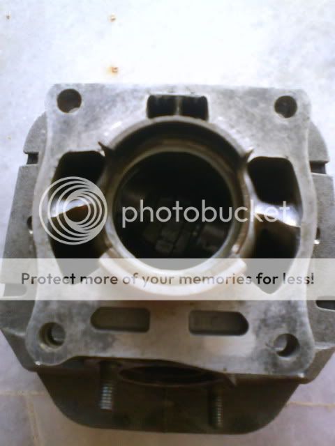

PostSubject: Re: Korek, Potong, Rebore, Port, Polish Blok & Potong Head V3   Tue Nov 09, 2010 7:22 pm
as u wish----
saiz piston 0.25..+ karb z.laju stended,pickup up ckt,fc lg jimat dr stended,rpm max 8.5 shj
piston saiz 1.25 + karb rxz = rpm 9.5k shj,pickup lbh ckt dr stended,fc same or lbh ckt dr stended,tgk cre bwk
piston saiz 1.00,+ karb stended +menjet + pilot stended=rpm 10k,myk lg jimat dr stended
p/s-gbr yg last kwn port,yg atas 2 tu port sendri..
PostSubject: Re: Korek, Potong, Rebore, Port, Polish Blok & Potong Head V3   Tue Nov 09, 2010 8:01 pm
wahh...yi...biar betol yg bwh tu leh dpt 10k..tp myk lg jimat dr stended affraid
karb stended+menjet+pilot stended=mksudnye xde kacaw pape la?stended kilang gtu? scratch

tc boy:byk siot blok..tokan blok ni..blok racing tu akan lemau ke TOP kalu wat long distance mcm yg byk org perkatakan...
yi_tupaijek01:performance gmbar last tu begitu mengujakan aku..rpm 10k,saiz dh 1.00,dh port,tp still pki jetting carb stended..ape rahsianya..lobang ekzos port x

PostSubject: Re: Korek, Potong, Rebore, Port, Polish Blok & Potong Head V3   Tue Nov 09, 2010 8:19 pm
jeng3..hehehe..rhsianyer kt lubg ejos,kalo tgk kt lubg ejos tu,npk port ckt je,tp xlebar,atas xusik,bwh xpasti byk mane dh usik..plug kaler perang,tp basah walaupon merembat(bkn nonstop)-ada 2 lg blok yg dh modi,tp xda gbr..kalo x,boleh share lg.
babet-semua stended,jetting stended,xkacaw pape kt karb ataupon kt head..head stended je.aku pon pelik knp blok ni leh setting ngn jetting stendard-tp spoket paling kck leh pakai 15-38,kalo kck lg gear 6 drop..so far 3 blok ni xpenah try kt highway-stkat jln bese n jambatan sultan mahmud jela Very Happy Very Happy
PostSubject: Re: Korek, Potong, Rebore, Port, Polish Blok & Potong Head V3   Tue Nov 09, 2010 8:31 pm
lobang ekzos kalu porting byk sgt mmg gear 6 drop giler kentang..tambah lak kalu pki sproket kecik2 dgn gearbox stended 125z..gear 6 stended 125z xdpt nk counter blik rpm yg drop tu kalu pki sproket kecik2...lain la kalu pki gear 6 rxz..
uish xporting keatas & ke tepi?..tp porting kebawah?..idea baru ni..so masa piston tu kt BDC(bottom dead center) akan menutup kawasan yg dh di port la tu kan..wah..
